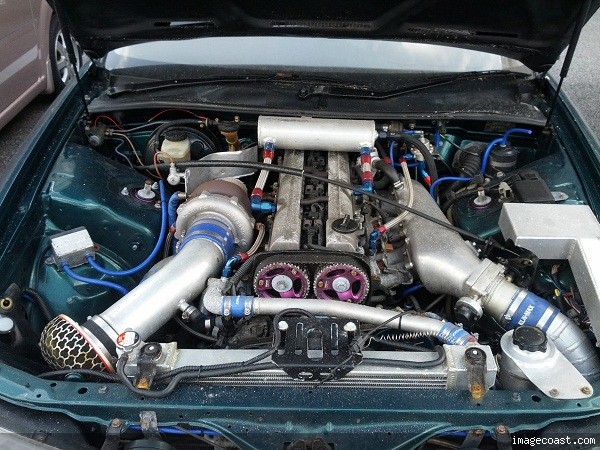

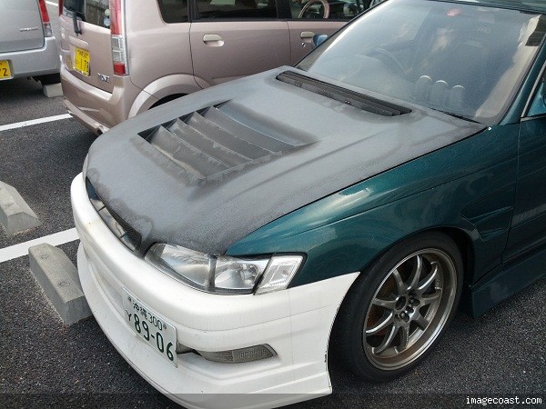

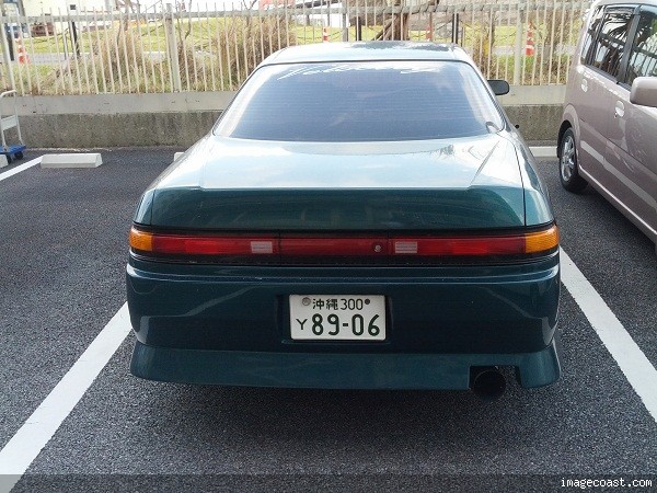

I told you she was like new, cause she is new.
I fast forwarded my build by getting extremely lucky.
I sold my old JZX90 and bought a friend of mines.
Gentleman, Meet The New Fat Girl
full aero (front and bumper and dmax hood need painted)
stereo - kenwood 25th anniversary 4 channel and 2 channel amp
12 inch kenwood sub in box. 6 1/2 inch components in front 6in 3way in rear door
kenwood single din head unit
Suspension - greddy hypermax full tap 12 adjust damper.
solid bushings for subframe engine transmission and diff
rear sway bar
trd diff with 3.9 final gear
Fuel system- sard collector tank with 2 sard 280 pumps, 1 walboro 255lph feed pump. 2 6an in lines to fuel rail, 1- 8an return, 800cc side feed injectors,
Engine- rebuilt 2jz , 272 cams, new springs and retainers, greddy intake manifold, 100mm throttle body, 3 core greddy intercooler, 52 mm aluminum radiator. gt-4088r turbine, greddy wastegate. stainless exhaust manifold. 80mm full exhaust.
